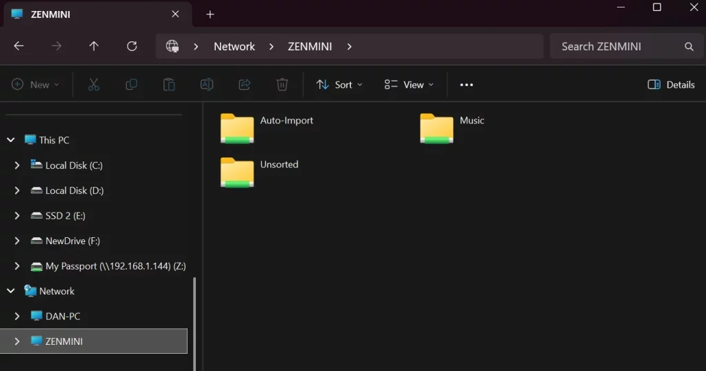

Windows: Accessing the Innuos server Shared Folders
We have now made updates so that Innuos systems will automatically appear as a shared network location in Windows.
To access the shared folders, you will need to enter the following credentials when prompted:
  • Username: guest
  • Password: innuos

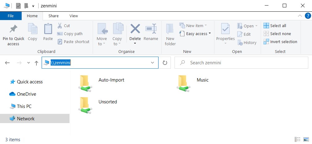

Open File Explorer and enter the \\hostname address of your server on the location path. Valid hostnames are zenmini, zen, zenith or statement depending on your server model. Please notice the use of “\\” double backslash chars at the beginning. You may also replace the hostname by the server’s current IP address on the network. See example picture above for Windows.
