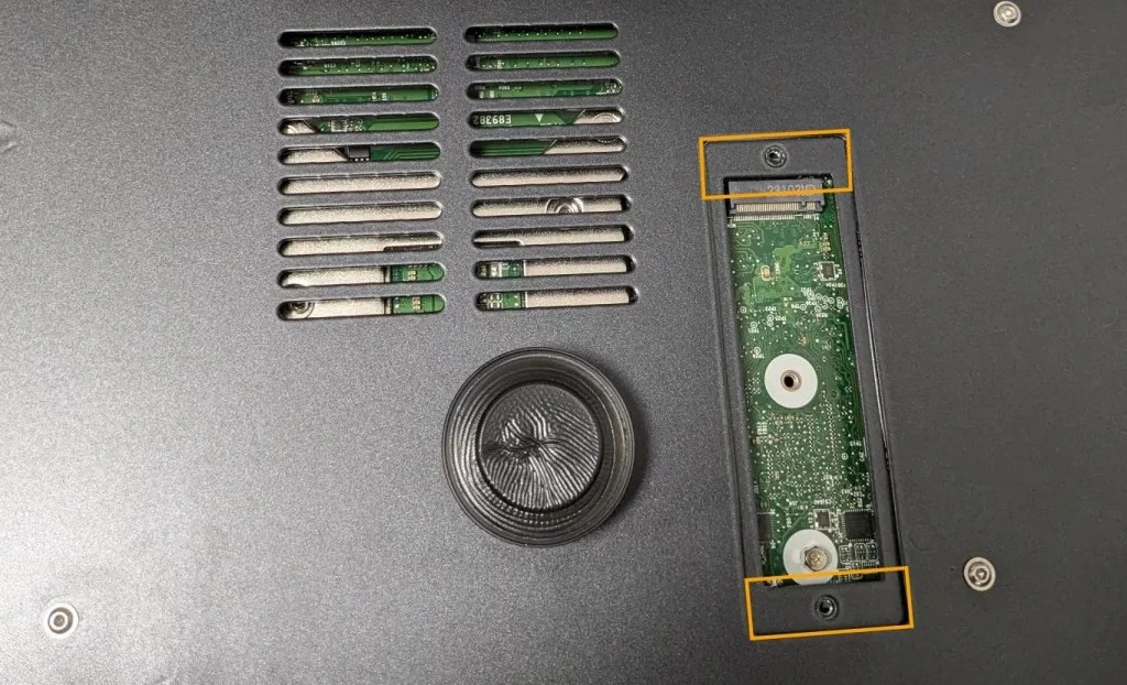

3. Use a 2mm hex or ‘allen’ key to remove the two screws holding the M2 backplate in place.
4. Using a narrow crosshead screwdriver, remove the screw from the standoff mount as pictured below.
5. Insert your M.2 SSD, then re-insert and tighten the holding screw.
6. Place the backplate back on and tighten the two 2mm screws.
