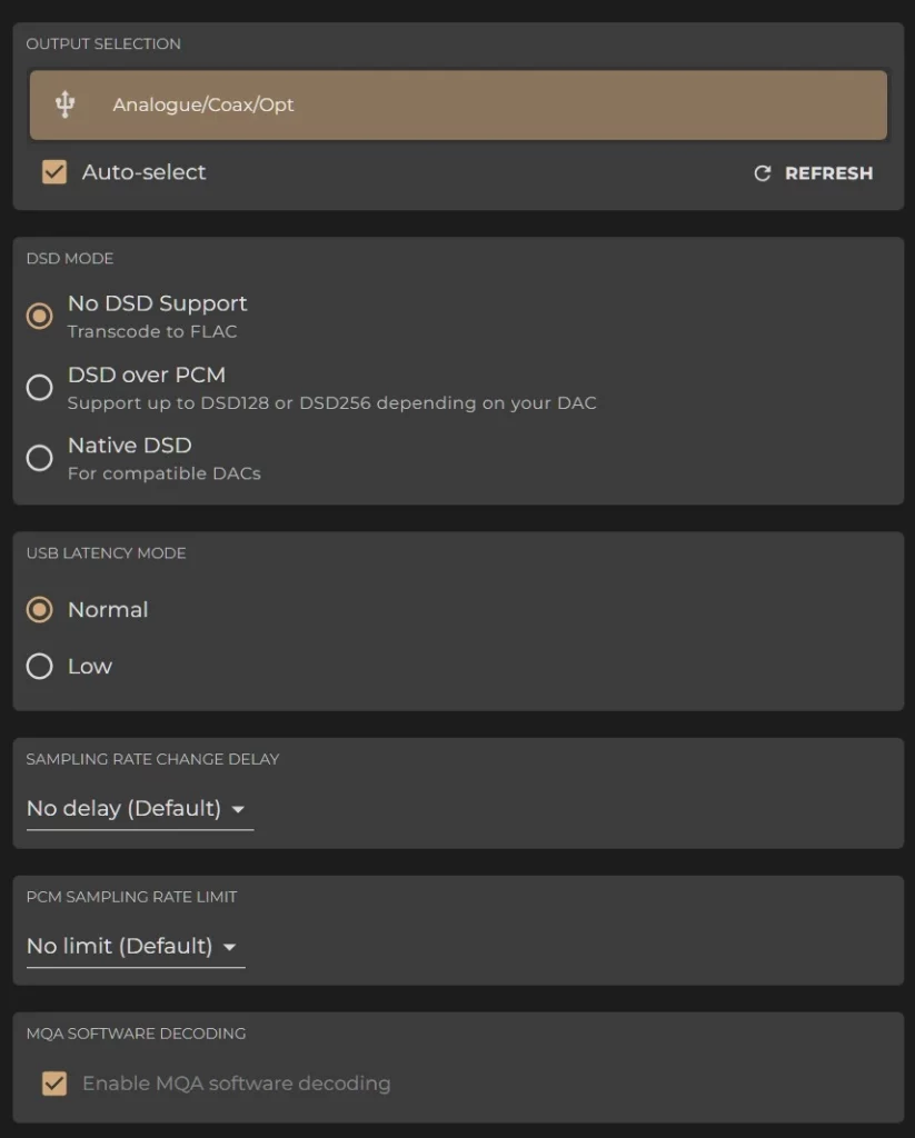

Output Selection
This will list any active outputs currently detected by the system.
Having Auto-Select enabled will make the system automatically switch to newly detected DACs, and switch to the next available output if the current/primary output device is disconnected.
Disable Auto-Select if you do not want the system to automatically switch output to available players, and instead you wish to manually specify the output type at all times.
If there have been a change of connected output devices or DACs, you can use Refresh to update the list of available outputs you can play through.
DSD Mode
Here you can set the DSD behaviour of the Innuos player when playing .DSF and .DFF files. If using an external DAC.
No DSD Support – This best used when your connected DAC has no DSD support at all or prefers high-resolution PCM (including DXD) instead.
DSD over PCM (DoP) – This allows DSD playback up to a maximum DSD256 through supported DACs and is the recommended mode if NativeDSD playback is not possible with your DAC.
Native DSD – This mode will play DSD natively if compatible with the connected DAC.
To play DSD256 and above, DACs will need to have support for NativeDSD playback at the base Operating System level – in the case of Innuos that is Linux. The DAC must be supported specifically on the Linux Kernel for this. If it’s not supported, you will need to select DoP (DSD over PCM) in order to play DSD up to DSD256
USB Latency Mode
By default, this parameter is set to ‘Normal’ to provide a safer buffer for USB DACs. However, setting it to ‘Low’ has the potential to enhance sound quality further. We recommend switching to ‘Low’ and testing the performance. If you encounter any issues, such as no sound or audible pops, simply revert the setting back to ‘Normal’.

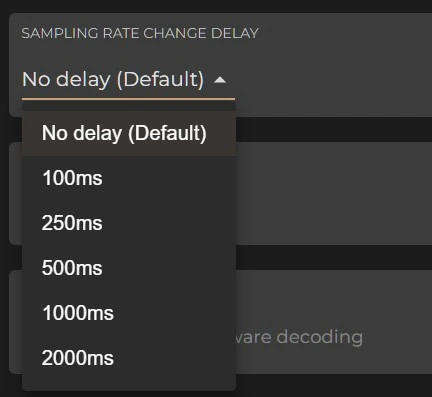

Sampling Rate Change Delay
Some DACs have a small delay in their output when switching between different sampling rates fed from the source, which can result in the very first beginning of the track being slightly cut-off. With this setting, you can apply a small delay to allow time for the DAC to change its switch in sample rate before the song is played, helping to ensure you do not truncate the beginning of the track.

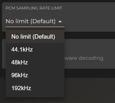

PCM Sampling Rate Limit
Here you can set a maximum Sampling Rate to the audio output, therefore downsampling any higher resolution files down to a lower rate so that it complies with any connected DACs that do not support certain resolutions. The current Sample Rate Limit options are 44.1kHz, 48kHz, 96kHz and 192kHz.

MQA Software Decoding
With this enabled, the Innuos system will perform the ‘first unfold’ of any MQA content in your library, regardless of the type of DAC that is connected.
