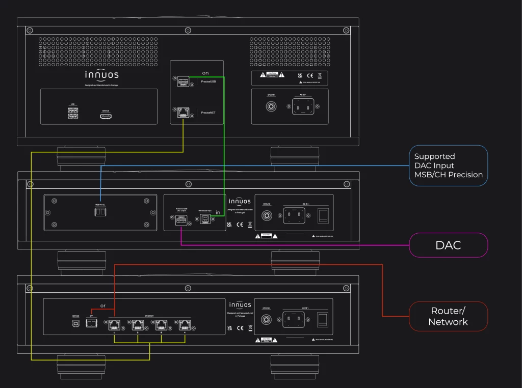

Using the Full Stack Nazaré
For users running the full NAZARÉ stack consisting of NAZARÉ, NazaréFLOW and NazaréNET, here is a wiring diagram to illustrate the connections.
