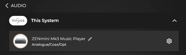

Your Innuos endpoint streamers should also be renamed for easier identification. To do this:
  • In the Sense app, go to the SYSTEM tab.
  • Go to SETTINGS
  • Go to AUDIO
  • Use the EDIT function (as represented by the ‘pencil icon’) to edit the name of the Player Output
Enter a new name of your choice, then select the tick/checkmark to apply.

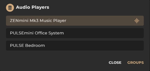

Now when you tap on the Player name at the bottom of the screen (or found in the Now Playing screen if using a smartphone), you will be presented with a list of all your available endpoints under ‘Audio Players’. From here, you can choose individual players to output to when playing music from your library.

  1. Select your player output in Sense app.
2. This will bring up your list of available endpoints
3. Select GROUPS. This will give you the option create a new group.
4. Select which players you would like to add to the group – your selections will be highlighted in gold to indicate they have been chosen. Press SAVE when you have finished choosing your desired endpoints.
5. On the next page, you will be able to give a name to this group, and if you would like to synchronise volume so that all endpoints match their volume to your main standalone system
