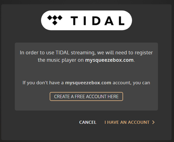

4. You will need a mysqueezebox account and you can create one by clicking on CREATE A FREE ACCOUNT HERE

​6. After this, go back to the TAB of your my.innuos.com > click on the Server icon > Settings > TIDAL > You can now select “I HAVE AN ACCOUNT” option and enter your mysqueezebox credentials
TIDAL setup window
7. After entering your myzqueezebox credentials and clicking Connect, the window will display the next steps so you can log in and install the TIDAL APP

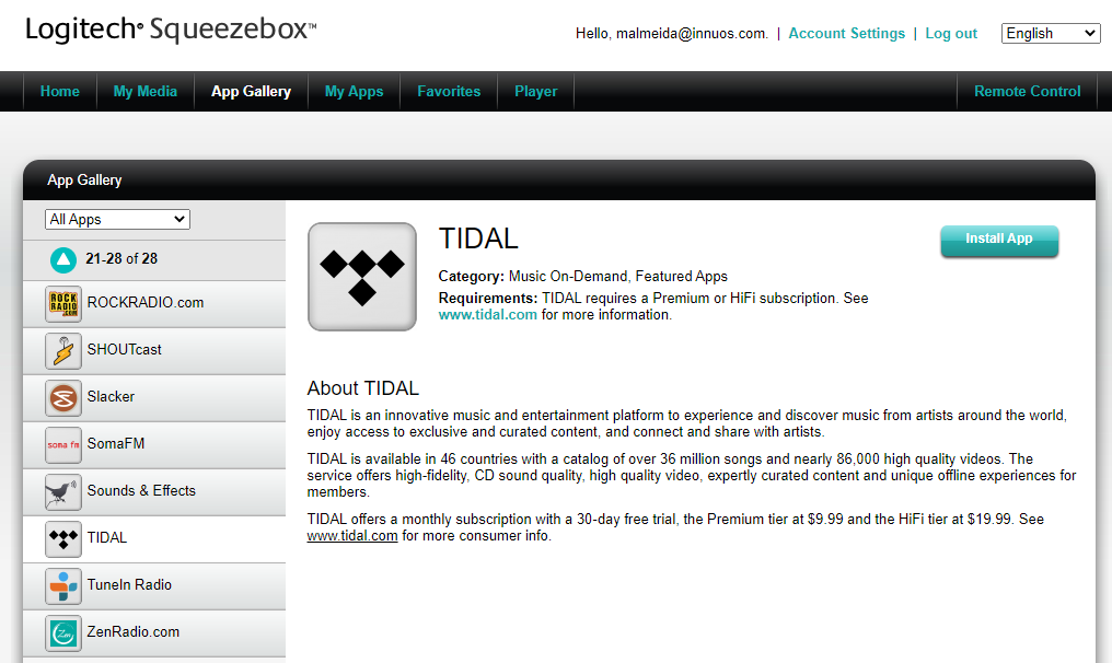

10. Afterwards, click back on the previous browser TAB > This will take you to the APPs Gallery > Click on the INSTALL APP on the right side of the screen
TIDAL Install APP option

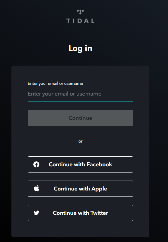

12- You are almost done, now just Enter your TIDAL credentials on the next window
TIDAL Login window
